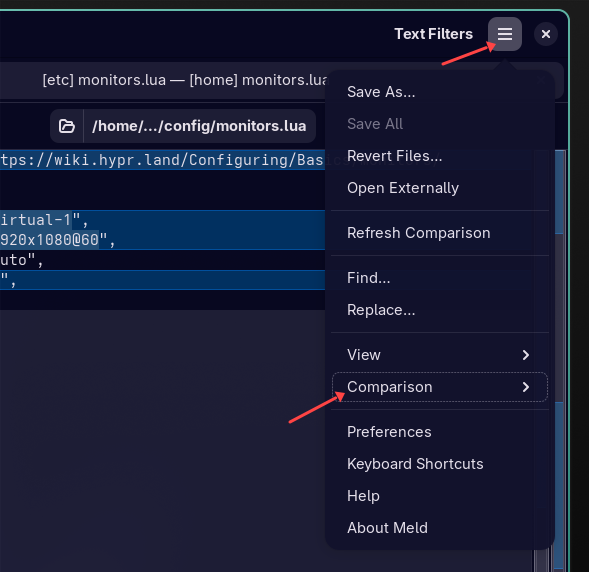

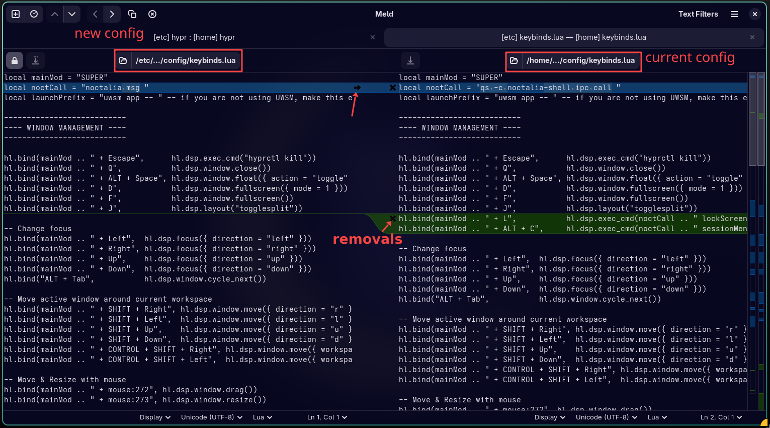

meldif you don’t have it (pacman -Q meldto check if you have it). - Run

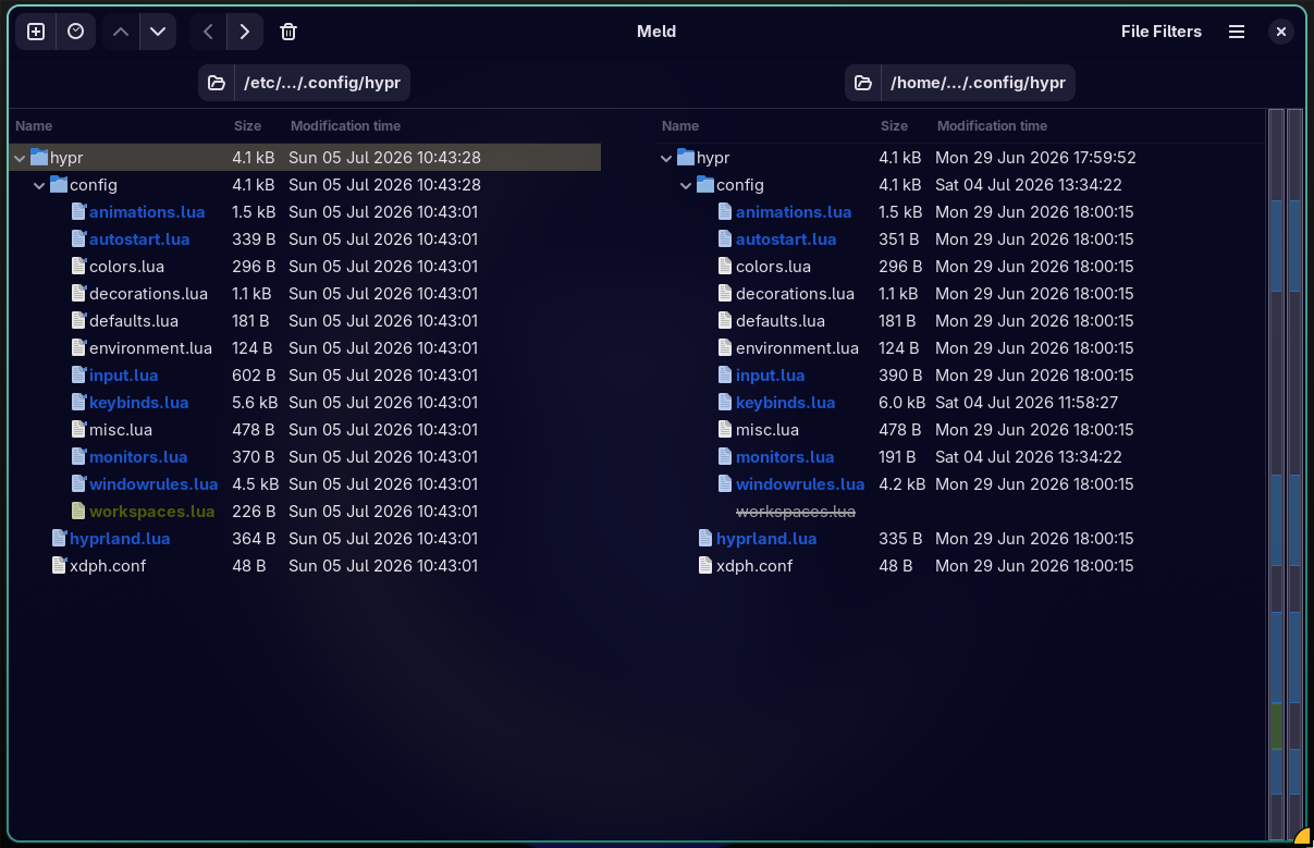

meld /etc/skel/.config/hypr ~/.config/hypr. - From meld you will see an overview of all the files with changes. Blue files have changes, while green files are net new.

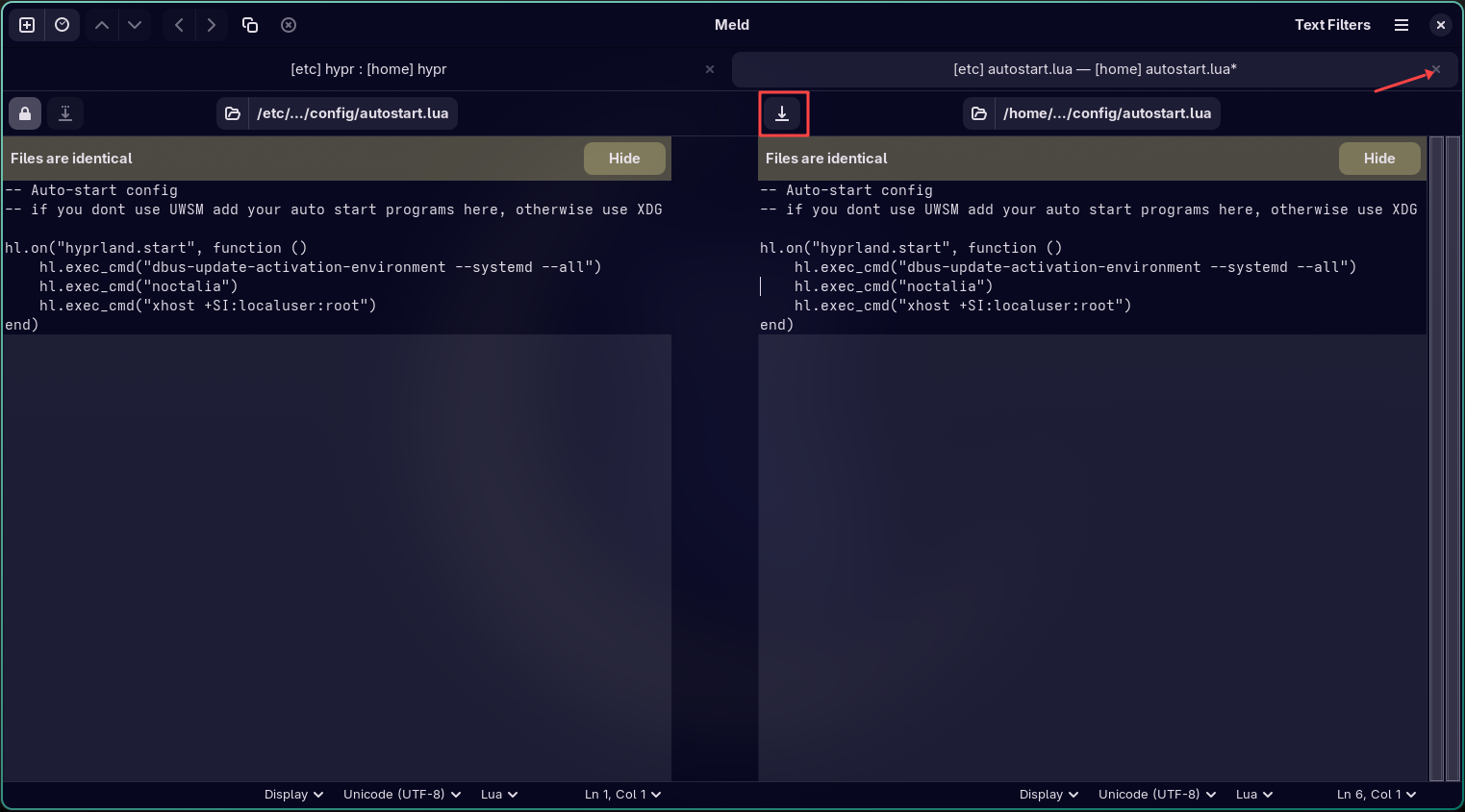

- Click into a blue file to see changes to be applied. You can use your best judgement to determine what to apply, but if you haven’t made any changes, it’s safe to overwrite the whole file. Click the arrow to apply changes and the x to remove old lines.

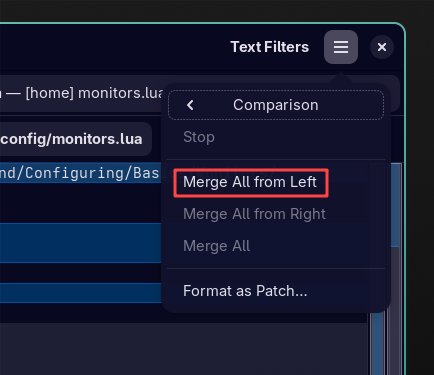

- You can merge all as well.
- When you’re finished with your changes for the file, save and exit.

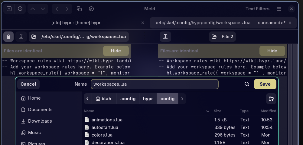

- The net new green files will ask where you want to save it. You can save it in
~/.config/hypr/config/with the same name. There are 4 new files.- defaults.lua is now variables.lua. You must manually move any custom additions/changes to the new file.
- keybinds.lua is now binds.lua. You must manually move any custom additions/changes to the new file.
- input.lua is now inputs.lua. You must manually move any custom additions/changes to the new file.
- workspaces.lua is new net and can be cleanly moved over without changes.
