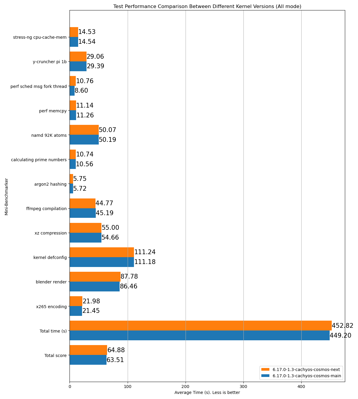

Benchmarking and comparing schedulers with cachyos-benchmarker
Section titled “Benchmarking and comparing schedulers with cachyos-benchmarker”The cachyos-benchmarker tool provides an easy way to evaluate and compare the performance of different CPU schedulers.
It runs a comprehensive suite of benchmarks to measure CPU, memory, and overall system performance under various workloads.
The following benchmarks are included:
| Test | Measures | Tool |
| stress-ng cpu-cache-mem | CPU, cache, and memory performance | stress-ng |
| FFmpeg compilation | Parallel build performance | make |
| x265 encoding | Video encoding throughput | x265 |
| argon2 hashing | Multithreaded password hashing | argon2 |
| perf sched msg | Context switching and IPC performance | perf |
| perf memcpy | Memory throughput memcpy() |
perf |
| prime calculation | Integer arithmetic and parallelism | primesieve |
| NAMD | Molecular dynamics (scientific workload) | namd3 |
| Blender render | CPU-only 3D rendering | blender |
| xz compression | Compression throughput | xz |
| Kernel defconfig build | Kernel compilation performance | make |
| y-cruncher | Mathematical precision and memory stress | y-cruncher |
cachyos-benchmarker can be used for several purposes, including:

Terminal output example:
stress-ng cpu-cache-mem: 15.26y-cruncher pi 1b: 31.23perf sched msg fork thread: 8.892perf memcpy: 13.53namd 92K atoms: 53.54calculating prime numbers: 11.126argon2 hashing: 6.62ffmpeg compilation: 53.38xz compression: 61.13kernel defconfig: 130.73blender render: 96.29x265 encoding: 24.99Total time (s): 506.72Total score: 70.71Name: p2dqDate: 2025-09-29-2115System: Kernel: 6.17.0-1.1-cachyos-p2dq arch: x86_64 bits: 64Desktop: KDE Plasma v: 6.4.5 Distro: CachyOSMemory: System RAM: total: 32 GiB available: 30.61 GiB used: 7.54 GiB (24.6%)Device-1: Channel-A DIMM 0 type: LPDDR5 size: 8 GiB speed: 7500 MT/sDevice-2: Channel-B DIMM 0 type: LPDDR5 size: 8 GiB speed: 7500 MT/sDevice-3: Channel-C DIMM 0 type: LPDDR5 size: 8 GiB speed: 7500 MT/sDevice-4: Channel-D DIMM 0 type: LPDDR5 size: 8 GiB speed: 7500 MT/sCPU: Info: 8-core model: AMD Ryzen 7 8845HS w/ Radeon 780M Graphics bits: 64 type: MT MCP cache: L2: 8 MiBSpeed (MHz): avg: 3366 min/max: 419/5138 cores: 1: 3366 2: 3366 3: 3366 4: 3366 5: 3366 6: 3366 7: 3366 8: 3366 9: 3366 10: 3366 11: 3366 12: 3366 13: 3366 14: 3366 15: 3366 16: 3366SCX Scheduler: p2dq_1.0.21_gf90c2aa1_dirty_x86_64_unknown_linux_gnuSCX Version: p2dq_1.0.21_gf90c2aa1_dirty_x86_64_unknown_linux_gnuVersion : 0.5.1-1HTML example of a test result comparing two different branches of the same scheduler:
